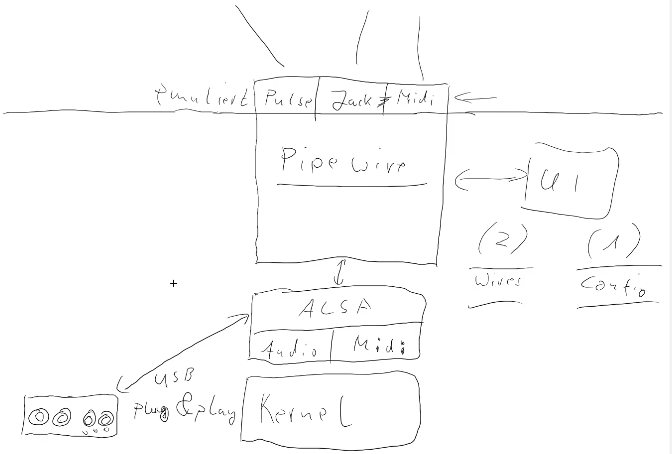

- Kernel >= 6.12 have PREEMPT_RT for real-time calculations and improved scheduling and Kernel >= 6.5 have MIDI 2.0.
- Pipewire >= 1.4.2 is functional/stable.
- Install Millisecond https://github.com/gaheldev/Millisecond or rtcqs https://codeberg.org/rtcqs/rtcqs and test your computer for audio optimization. Adjust as necessary according to the instructions.
Installand Cable https://github.com/magillos/CableCode: Alles auswählen
pipewire-alsa pipewire-jack wireplumber qpwgraph
It doesn’t matter which audio server each program uses, since Pipewire can emulate them all at the same time. So audio (pulseaudio, jack), MIDI, video, ... . Everything is plug-and-play. The easiest way to set it up is via Cable.- The sound system itself:

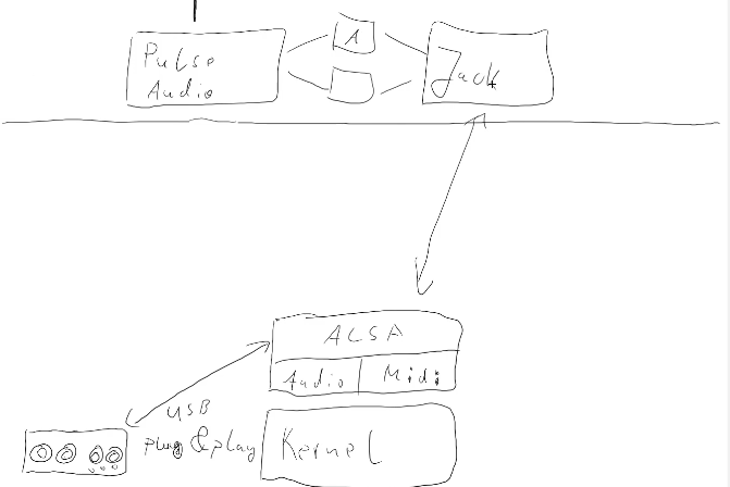

==> Installiere "a2jmidid" und "pulseaudio-module-jack".
In qjackctl Einstellungen:
Jack mit a2jmidid und pulseaudio:
- Einstellungen >> Einstellungen > Parameters > MIDI Drivers "seq"
- Einstellungen >> Einstellungen > Advanced > "Server Prefix" select "jackd" https://github.com/jackaudio/jack2/blob/master/README)
- Einstellungen >> Einstellungen > Advanced > [X] Soft Mode
- Einstellungen >> Einstellungen > Advanced > (RT) Priority (0 - 98)
- Einstellungen >> Optionen > [X] Skript nach dem Start ausführen: "pacmd load-module module-jack-source channels=2 && pacmd load-module module-jack-sink channels=2 && sleep 5 && a2j -e &" (mit dbus) oder "sleep 5 && a2jmidid -e &" (ohne dbus)
- Einstellungen >> Optionen > [X] Skript beim Herunterfahren ausführen: "pulseaudio --kill"
- Einstellungen >> Optionen > [X] Skript nach dem Herunterfahren ausführen: "killall jackd"
- Einstellungen >> Verschiedenes > [X] Provide support for ALSA sequencer
